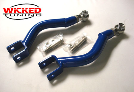

Hey have anyone tried to or attempt to use S13 RUCA on FGY33 rather than S14 RUCA?
Seems like the S13 RUCA have more curves than the S14 RUCA that may clear the strut seat.
What do you think ?

LS14January 8, 2009
#218818
I've thought the same thing and have a feeling it will clear. If you do it and it doesn't hit while unloaded, let us all know! It shouldn't be hard for me to sell mine to the 240 guys for almost what I have in them.
