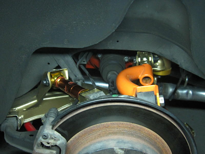

Brokey33January 16, 2010
#294701
Those are it right there. Thanks for the post Dan.
Hey pisto, how's the BV arms get you more neg camber if you make it longer. The only way I can see if the PBM arms could add more neg cam is if it was shortened.
IDK about this, and I'm sure its not recommended, but Dan, you think if by removing the smaller locking nut, the one on the far left, it'd cause the heim joint to back out?? I imagine it wouldn't since it'd be locked in through the eye, and the threads would be locked in place with the adjusting threads and its locking nut?? Whatcha think??
#294714
Did a lil research, and Pisto, I believe your RCA goes on bottom right??
That would make sence why it'd have to be longer.
Ours go on top, mine is pictured there on the right
That's why I need to go it shorter :sad:
[IMG]http://lh5.ggpht.com/_yTr40MAMZU8/S0_OC6Ea2aI/AAAAAAAAANs/OqZCUooGKaY/s800/Links2.JPG?source=androidclient[/IMG]

that's the part i shortened on my peak arms -- they had a larger collar there. anyway, apologies for the bad photoshop (and i did use photoshop, not paint). i'm drunk as shit right now hahaha
[IMG]http://i49.tinypic.com/nvuphd.jpg[/IMG]
Brokey33January 17, 2010
#294902
LOL it's all good man
But the PBM arms dont have threads all the way through the inner part of that tube, they're maybe half way. Something like this
Here you can see the inner part's smooth. You cant see any threads till the very end.
Stole this from PBM site
this highlights the only visable thread barely beginning
[IMG]http://lh4.ggpht.com/_yTr40MAMZU8/S1Ne4OW4f5I/AAAAAAAAAPY/r7ev_NPSfm4/s800/PBM%20RUCA.JPG[/IMG]
[IMG]http://www.gtfactory.jp/cms/e107_files/public/1209858923_2_FT0_p1030270.jpg[/IMG]
[IMG]http://lh6.ggpht.com/_yTr40MAMZU8/S1Ne4u6wX8I/AAAAAAAAAPc/c2Wkdfcdgmw/s800/PBM%20RUCAa.JPG[/IMG]

cheez80January 18, 2010
#295027
maybe a competent machine shop can rethread or extend threads on the inside for you? sounds crazy, but people told me i couldn't shorten my peak arms =P

Tanuma BodyJanuary 19, 2010
#295250
SanDiegoG35;294915 wrote:me and my friend are gonna make our own fender roller, if you still need one.
why would you do that they are not that expensive. and even less to rent.
Brokey33;294902 wrote:LOL it's all good man
its half way because thats the length of the adjuster. The inside of the adjuster on the other hand is threaded all the way and the threads on the ball joint are really long.
Point is you can make it shorter without any modification.
[QUOTE=SanDiegoG35;294915]me and my friend are gonna make our own fender roller, if you still need one.[/QUOTE]
[QUOTE=Brokey33;294902]LOL it's all good man
But the PBM arms dont have threads all the way through the inner part of that tube, they're maybe half way.[/QUOTE]
Brokey33January 19, 2010
#295305
Will try that. Just crank down the adjuster till it locks into the sleeve. And get the ball joint to my desired length. And slop lock-tite over all of it, right??
Tanuma BodyJanuary 20, 2010
#295405
right
a little goes a long way so i would not say slop it on
the red loctite is permanent and the blue type is removable
right
