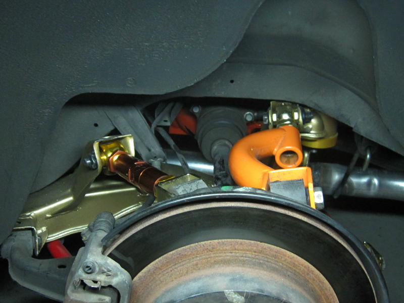

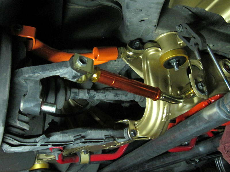

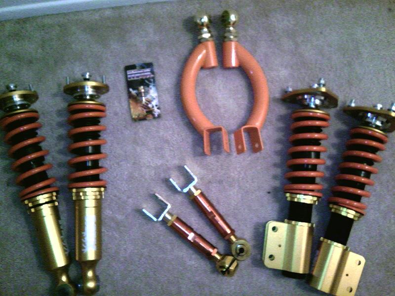

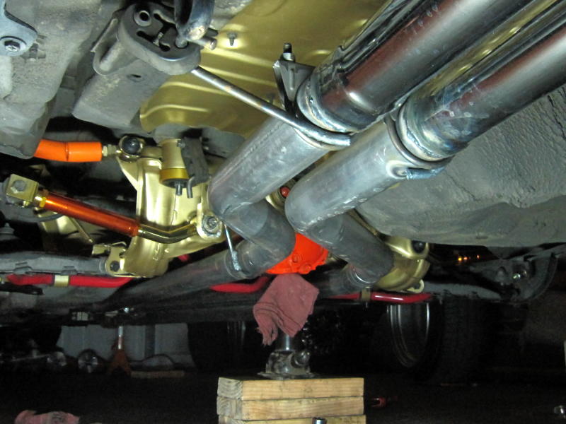

Nah, Y33 guys already got it covered
-S13/ S14 Coilovers (personally I got the S13's)
-Traction Rods
-RUCA
-Toe Rods
-Tension Rods
-Subframe Risers
Parts Shop Max FTW
Before I got my Toe Rods cause they were waiting on the new shipment this past summer
Everyone trips when they see the bottom of my ride cause of the colors :dance:
-Traction Rods
-RUCA
-Toe Rods
-Tension Rods
-Subframe Risers
Parts Shop Max FTW
[IMG]http://lh3.ggpht.com/_yTr40MAMZU8/S0_N_bnSL4I/AAAAAAAAANk/wXWzfkiPQyA/s800/PBM.JPG[/IMG]
[IMG]http://lh5.ggpht.com/_yTr40MAMZU8/S0_OC6Ea2aI/AAAAAAAAANs/OqZCUooGKaY/s800/Links2.JPG[/IMG]
[IMG]http://lh5.ggpht.com/_yTr40MAMZU8/S0_KTRSAKkI/AAAAAAAAANg/N4plYr5tyEA/s800/Links3.JPG[/IMG]
[IMG]http://lh6.ggpht.com/_yTr40MAMZU8/S0_OA4t_H1I/AAAAAAAAANo/Wdf6KZJ4uB0/s800/Links4.JPG[/IMG]
interesting, never saw my stuff in a q45, looks sextacular!!!
even if the multilink bolted on Im sure the coilovers did not.
Let me see your coilover modifications.
Are you sure you can use the S14 coilovers too? - the holes in the front bottom mount are bigger, the rear coilover is much longer, and the rear upper mount is bigger.

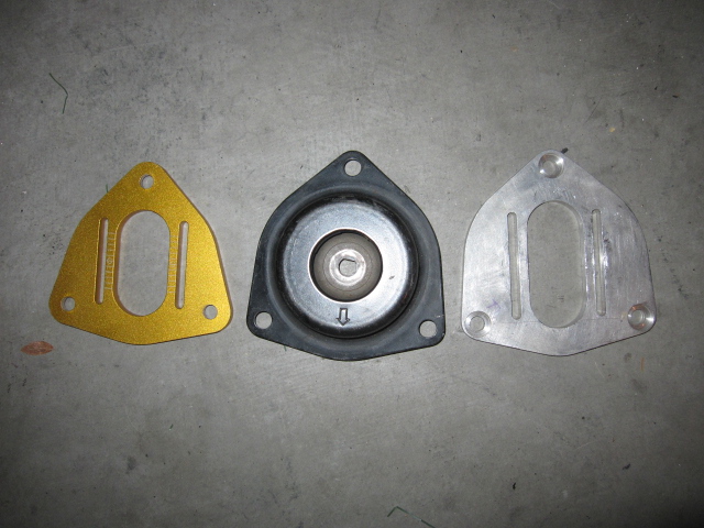

That my friend, you're right about.
Dont know if you remember, a few months back i hit you up on Zilvia through PM's with the order and about making this for a Y33, only thing was that I would've had to have the car down for weeks, while y'all machined the top hats, and i couldn't wait cause this is my daily. That plus the several trips I'd have to make to SD was gonna be killer. So I schemed something up and found a water jet shop close by to cut out my design.
Its the inner dimensions of the PBM top hats, with the outter dimensions for the stock top hats. These are the rears
PBM on left My custom ones on right
I believe the rear S14 tops fit stock Y33 mounting locations, but since i used S13 coils, I needed mine made
Fronts top hats
And full S13 conversion, so that the lower part could bolt up, Stock Y33 suspenion uses spindles attached to the shock body

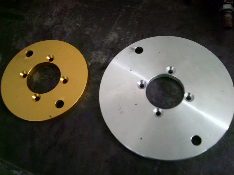

Fronts top hats

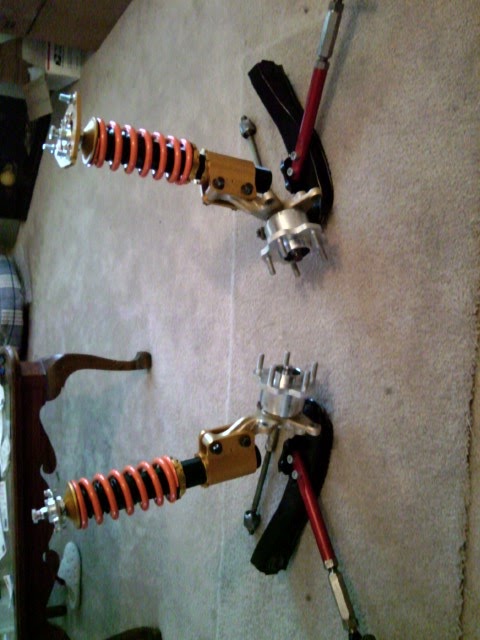

[IMG]http://lh4.ggpht.com/_yTr40MAMZU8/S0_hL7oRMDI/AAAAAAAAAOc/s4yGG5Eqx54/s800/0905091903.jpg[/IMG]
Ooooppps
The ride is gansta. Still super stiff to hold up this beast of a vehicle, compared to being built for a car that weighs half as much.

I imagine it must ride pretty good. I would like to go for a spin and hear what damping setting you use.
I like all that good work! Thats a proper job you did with the retrofit.
I wonder how many Y33 people there are willing to do that? Probably not many, but if it makes it easier I can make the Y33 top plates if there are some people willing to buy it...
I can check the S14 top plate to confirm fitment if you have a dimension on that
the rear lower is ok on the stock y33 knuckle mounting diameter?

alright I finished the CAD for the Y33
front lower can weld on to stock knuckle (preferred method)
or
Garage spec DIY install by cutting down the strut, drilling holes, through bolting and sealing with epoxy
front upper
or
[IMG]http://www.gtfactory.jp/cms/e107_files/public/1265420768_2_FT0_y33fl.jpg[/IMG]
front upper
[IMG]http://www.gtfactory.jp/cms/e107_files/public/1265420768_2_FT0_y33fu.jpg[/IMG]

Tanuma Body;298567 wrote:alright I finished the CAD for the Y33
or
front upper
any updates on the possibility of these top hats getting made by you?
[QUOTE=Tanuma Body;298567]alright I finished the CAD for the Y33
or
front upper
[IMG]http://www.gtfactory.jp/cms/e107_files/public/1265420768_2_FT0_y33fu.jpg[/IMG][/QUOTE]

So there is some major updates to the van build after some major setbacks:
The biggest thing that has held us back is the transmission. We have tried transmissions from the QX4, G35, Titan, and finally we have found the correct combo, the 05+ Pathfinder / Xterra / Frontier tranny (less bellhousing because in the USA this mission bolts to a VQ40). Unfortunately there is no published info out there on input shaft length, shift lever position, output shaft style, computer, plugs, and bell housing so we just had to see what worked. At least this expensive trial and error transmissions has finally concluded with a $700 2008 Xterra unit obtained from San Diego Wrecking yard Tapatio. They are very professional and actually let you warranty or exchange parts within 30 days if it does not fit as you planned. The JDM bell housing and the Xterra torque converter bolted everything together. JDM exhaust manifolds and engine mounts will allow for a smooth install.
We have made major progress on the suspension and body work too!
3M panel bonding adhesive to attach the door panels and then we did some bodywork to smooth out the lines to make the parts look one piece with the doors.
MRR design 20″ wheels with 235/40/20 tires fill whe arches.
Parts Shop MAX customized some coilovers using parts from S13, S14, Genesis, FD RX7 and custom fab pieces. The coilovers are adjusted as high as they can go, so you know this thing can really be in the weeds, and while the front end sits a little higher in these photos, it should level out after the engine is bolted in.
