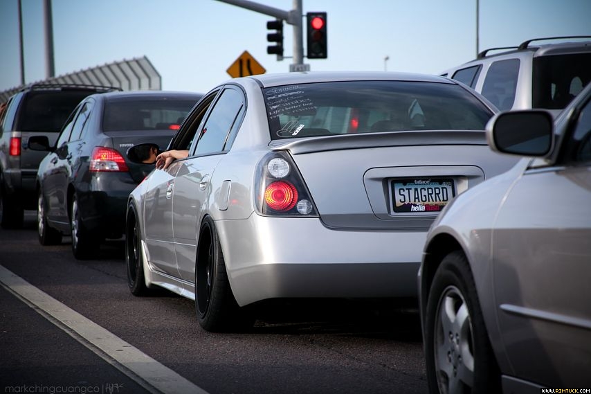

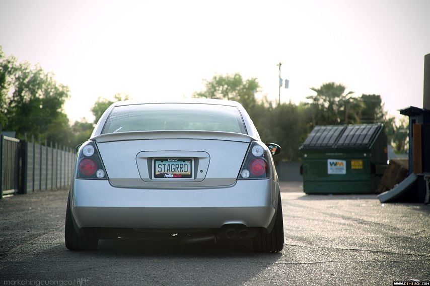

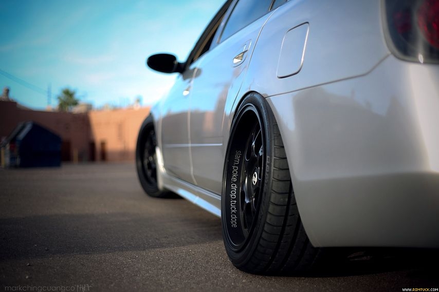

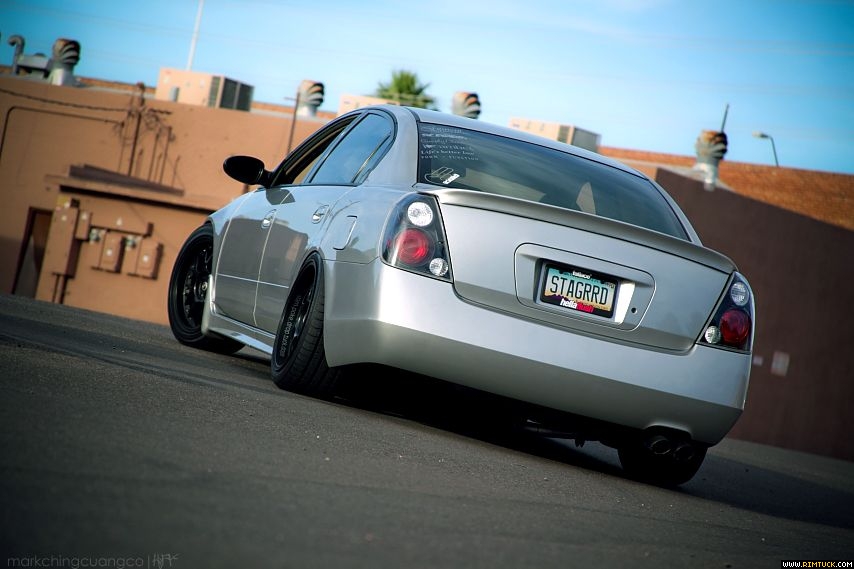

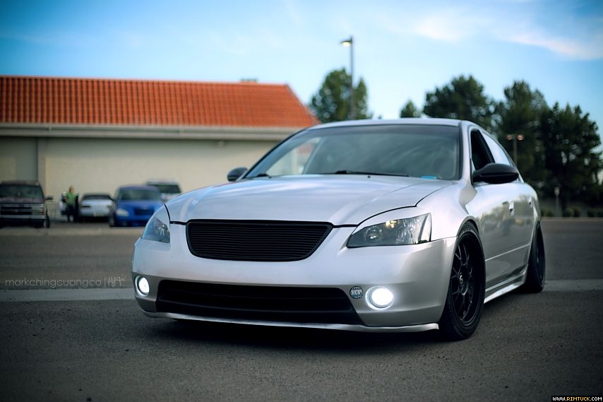

I was looking at the M45 above which has a 20 x 10 5" lip in front and a 20 x 10.5 5.5" lip in back. It looks like they didn't do any fender mods on the front/maybe sliight camber and a slight pull/camber in the rear.
I actually have a 2005 Nissan Altima....An Altima had the same wheels I had and stance, pics below (He has since changed wheels and is now riding on 20 x 10 38et), but the ones I currently have are 20 x 9.5 35et and lowered on coilovers. Fit with just fender roll and camber in rear. I would love to have 20 x 10 5" lip (VIP Modular VR01, like the above M45 has in front) for my Altima all 4's. Guess time will tell..

You had to roll and camber to fit a 20x9.5 +35, and you want to run a 20x10 with a 5" lip? Good luck. A 5" lip on a flat faced 20x10 is at least a -6 offset (assuming 0 face thickness). That's another 47mm on the outside edge. Hello widebody or -524059347650476 camber.
Y50 fenders are wayyyyy deeper than Altima fenders. Trust me, I have an 03 Altima, and my dad had an M35. Flush on a 3G Altima is damn near stock fitment on a Y50. I'm currently running 19x9.5 +30F +35R and I honestly can't go much more aggressive than that without major body work.

princeholidayApril 14, 2011
#382186
Looks like I can go a 9.5 20et ...Hmmm....:)))
This Altima has these specs.. f 18x8.5 25 r 18 x 9.5 20 and these are on 245/40-45 tires..which I definitely won't be running.. I have hope!!!!! *LOL*
[IMG]http://rimtuck.com/photos/1273885894.jpg[/IMG]
[IMG]http://rimtuck.com/photos/1273885933.jpg[/IMG]
[IMG]http://rimtuck.com/photos/1273885961.jpg[/IMG]
[IMG]http://rimtuck.com/photos/1273886003.jpg[/IMG]
[IMG]http://rimtuck.com/photos/1273886038.jpg[/IMG]
