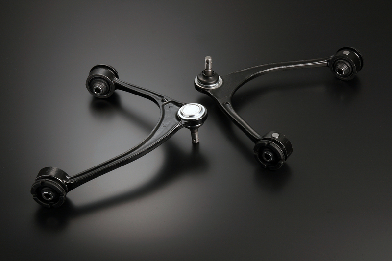

OGMarch 19, 2012
#443019
[IMG]https://www.moonface.co.jp/imgdb/item_data/36-1.jpg[/IMG]
