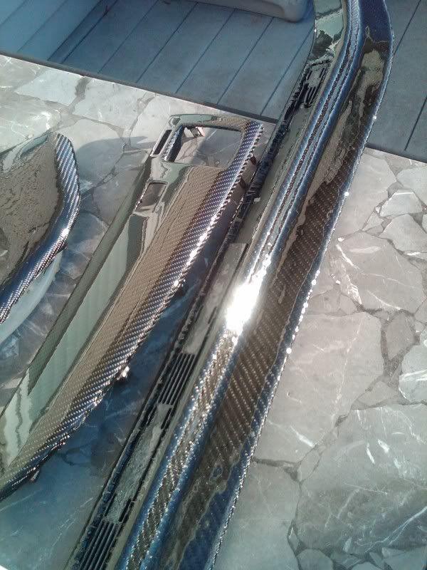

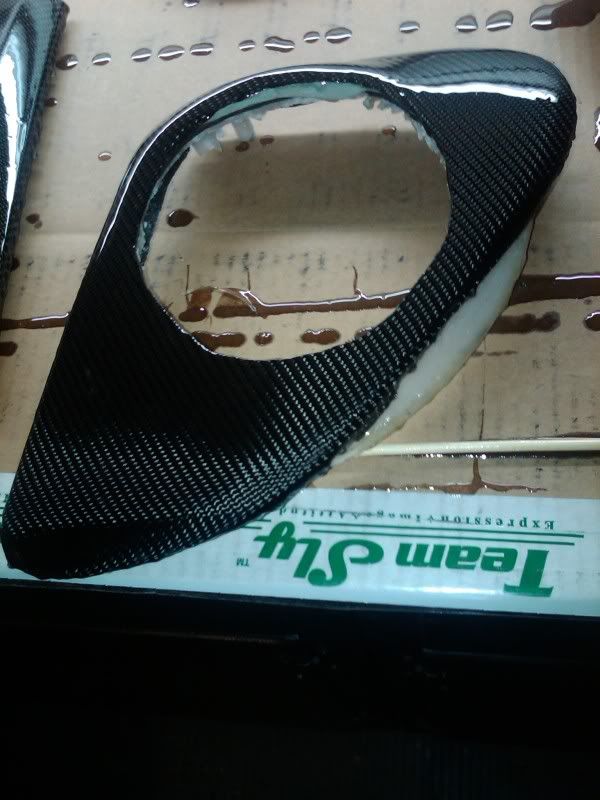

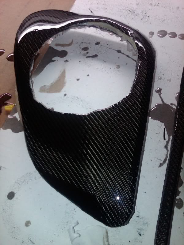

actolexApril 20, 2012
#448517
Pods are done.....decided to do the door sills too!
[IMG]http://i16.photobucket.com/albums/b13/actolex/SC430/Pod1.jpg[/IMG]
[IMG]http://i16.photobucket.com/albums/b13/actolex/SC430/Pod2.jpg[/IMG]
[IMG]http://i16.photobucket.com/albums/b13/actolex/SC430/Sills.jpg[/IMG]
