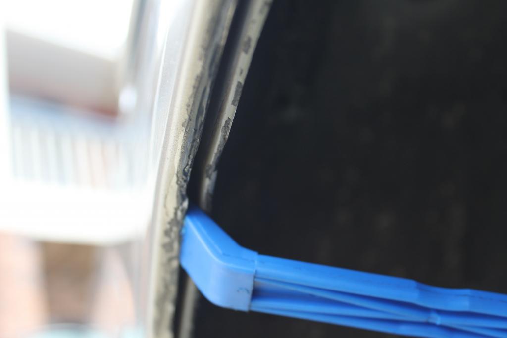

Update:
Need your help OG and DONECD6. So I bought the seam splitter and got the fender apart today. I didn't try to split it more than this because I didn't want to cause a dimple on the outside. Is it supposed to split more than this? If not, what can I use to get the epoxy up there? The nozzle for the 3m epoxy is too big to get up there. I tried a small livestock needle before and it was too small. The epoxy was too viscous to flow through such a small needle. Any suggestions, really need your help.
Update:

tiger4lifeAugust 26, 2012
#462211
datplayaz;461900 wrote:Any pictures of how you did it?
So I got the epoxy in today, hopefully it holds that panels together. Below is a picture of the turkey injector needle attached to the 3m nozzle.
[QUOTE=datplayaz;461900]Any pictures of how you did it?[/QUOTE]
