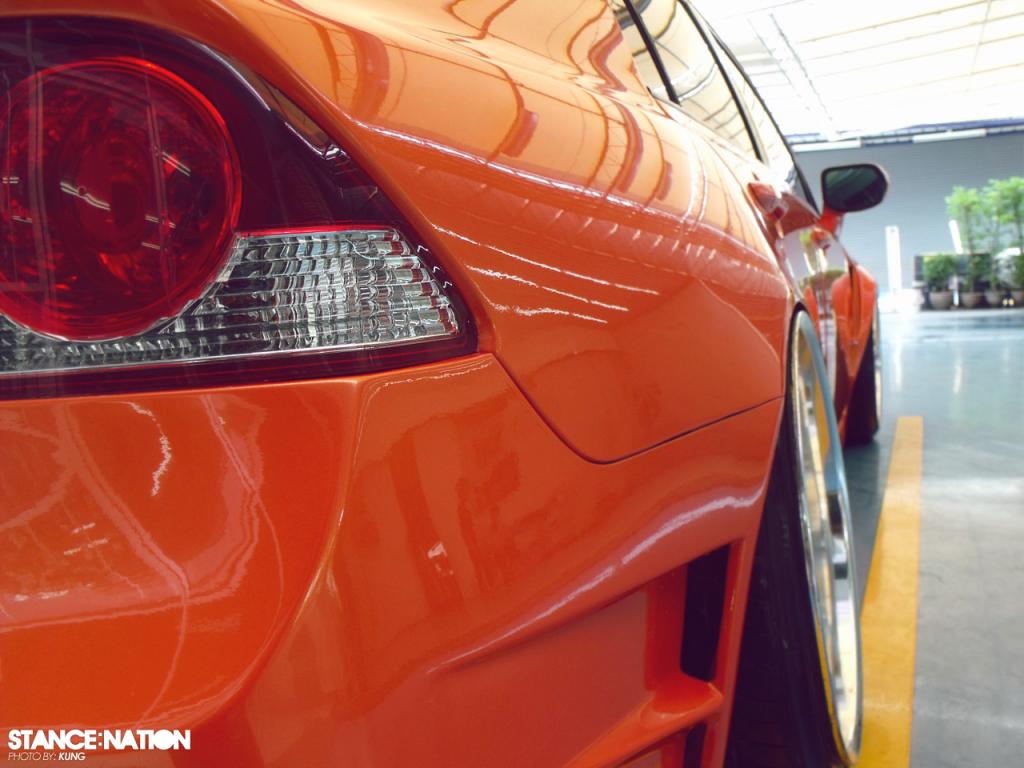

TryllZMarch 16, 2013
#487960
Hi,
Im planning to lower my car too and do a little of fender pulling too but I don't understand whether the bumper will be pulled too together [or is it possible to pull the bumper too together with a little bit of heating on the bumper] or is the bumper a separate work to be done ?
Something like this:
Attachment 4120
Attachment 4125
Attachment 4124
Attachment 4122
Attachment 4126
And my preferred one, I need this type of fender rolling:
Attachment 4121
Thank You

galen696969March 23, 2013
#488488
Don't think you'd need to worry about the bumper too much for rolling and pulling since that wouldn't widen too significantly, whereas widening the body can be quite significant.
