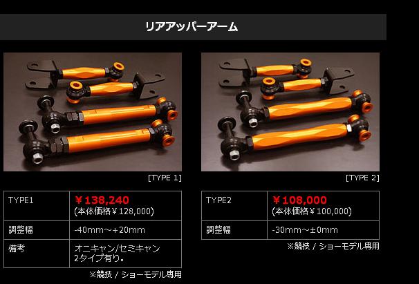

so forgive me for asking a noob question or wanting clarity on a noob-ish question, but if i just want to pull in the top of the rear wheel say 1/4" would that be an adjustable rear upper arm like this here? would anything else likely be required or just that?
and BTW the T-demand one is damn near $850. at this point a slightly smaller set of wheels may be the easier route to take.
Attachment 6852
these are all the arms and arm pieces that T-demand makes for my car presently.
http://www.t-demand.jp/products/proarm_t07.html
[ATTACH]6852[/ATTACH]
[URL]http://www.t-demand.jp/products/proarm_t07.html[/URL]

yeah, you'd need an adjustable rear upper arm. you could do the cheap route and have someone cut your stock one and add an adjuster. other than that, you're probably SOL, it's not a very common chassis.

i might have to pass on the upper arms option since most recommend the lower and toe arms all at the same time and i ain't got crazy loot to be droppin $2500 for some extra rear camber. i'd rather put that into the correct sized wheels...
but here are some recent shots with the car at L on the controller. can't drive it at this height, just for looks, you know¿
at this height without the body kit it would be about 2" from scraping. when the kit gets put on it might be touching the ground on L mode... gonna look pretty sweet to me for pics. just wish i could drive it at a lower setting.
at the 9 setting on the controller it is like 1.5" too high to me. i want the above tire gap height when driving. that is gonna require 20" wheels of a slightly thinner make, and another 20mm drop... maybe version 2.3 ;)

I thought i saw megan has one for 18 crown, gonna dig through my mags, i am sure i saw it somewhere

mrbrian8;515829 wrote:I thought i saw megan has one for 18 crown, gonna dig through my mags, i am sure i saw it somewhere
Assuming Majesta is same as normal 18 yeah they have some
http://www.meganracing.co.jp/products/suspensionparts/arm/crown.html

#515832
mlracing;515830 wrote:Assuming Majesta is same as normal 18 yeah they have some
i don't know if they fit both chassis (mine is the UZS186 now, i used to have the grs18#). i've actually seen them separated out on one site and not separated out on others.
i just put up a pic of that Megan site along with my question in japanese on a japanese crown page, so hopefully i will know something soon. but if they do fit then i am definitely getting those, thanks for the link mlracing. those at 25,920 yen are a lot cheaper.
[QUOTE=mlracing;515830]Assuming Majesta is same as normal 18 yeah they have some
[URL]http://www.meganracing.co.jp/products/suspensionparts/arm/crown.html[/URL][/QUOTE]

sojah;515832 wrote:i don't know if they fit both chassis (mine is the UZS186 now, i used to have the grs18#). i've actually seen them separated out on one site and not separated out on others.
3gs/grx markX/lexus IS and 18/20 crown stuff fits bro. also factory IS UCA's are shorter than 18 ones, gives you -6.5 camber

sojah;515838 wrote:thanks alpha. i also just got confirmation on the 18 crown site that they are good. so those adjustable megan UCA's are like $200. i'm thinking of running like -5 to -6 degrees in the rear. i hope the UCA's will do the trick but now i'm wondering if that will mess with the toe too much and require the other arms/rods.
you need 2x arms on rear to get camber bro, pain in the ass but the only way how to achieve camber on rear.

alpha;515841 wrote:you need 2x arms on rear to get camber bro, pain in the ass but the only way how to achieve camber on rear.
so you think it is okay to just go with the upper and lower rear arms for safely adding the negative camber for th rear?
the car shop my car is at told me last night that they recommended just getting all the arms for the rear. but that is 4 different types of arms; upper arms, lower arms, tension rod, and toe control arm. adding the tension rod and toe control arm adds another $500 just for parts and another $200 for install so if i can safely avoid that $700 i would like to do that.
just upper and lower rear arms are like $700 plus shipping and install is close to $1000.

alphaMay 27, 2015
#515855
MRS-LX-0321
MRS-LX-0311
these are megan racing amrs you will need. rear upper arms, and rear upper front arm, this will bring top of the wheel inside
shouldnt cost you any more than 26000yen per set

alphaMay 28, 2015
#515867
sojah;515864 wrote:come again? what exactly are you talking about? presently the car has the dataSystems controller, stock air ride, and the YouZeland SS kit that drops the body 3cm.
this here bro
http://page10.auctions.yahoo.co.jp/jp/auction/m133184812
same as SS kit, but it actually brings the bottom out.
and this for rear
and this for rear
http://page6.auctions.yahoo.co.jp/jp/auction/f148626130
front and rear combo is about 47k yen
