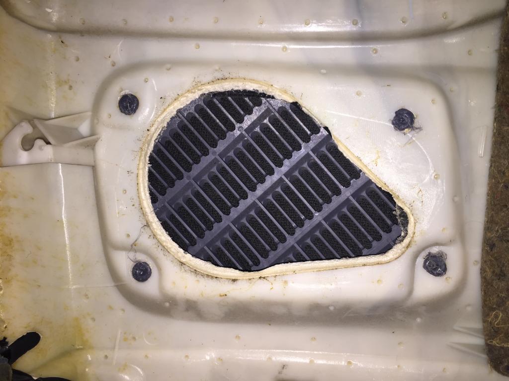

I Need some help/advice on how to remove and replace these melted plastic tabs that hold in the speaker grills and door pads. I'm wanting to change our the speaker cloth and do some door inserts but I have no idea what to do with these things.
anyone have experience with this?

If I were you, I'd carefully slice the melted component off, and then on re-assembly I'd drill a small hole in the post of the speaker grill. Use a washer and a light-duty screw and screw them back in

Yeah I'm thinking the same thing. I got an idea from a friend as a back up to use some Suzuki samurai fasteners and CA glue, also. So I'm gonna give the screw method a shot first. 👍
