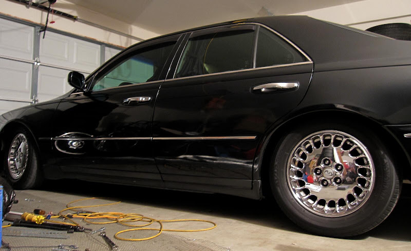

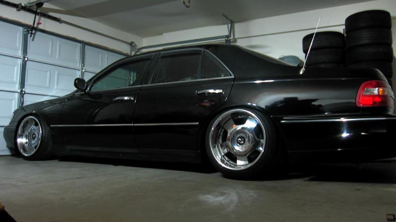

#173382
Just FYI FC RX7 rear coils will work as well but you still have to use S14 rear top hats... if anyone is doing this I have an extra set of rear S14 Cusco top hats... PM me if you need em.
Heres how mine came out-
[IMG]http://i37.tinypic.com/169mecp.jpg[/IMG]
[IMG]http://i37.tinypic.com/2mdghnq.jpg[/IMG]
[IMG]http://i37.tinypic.com/jg5x6g.jpg[/IMG]

Cedric;173382 wrote:Just FYI FC RX7 rear coils will work as well but you still have to use S14 rear top hats... if anyone is doing this I have an extra set of rear S14 Cusco top hats... PM me if you need em.
If you ever want to sell ur car I will buy her
[quote=Cedric;173382]Just FYI FC RX7 rear coils will work as well but you still have to use S14 rear top hats... if anyone is doing this I have an extra set of rear S14 Cusco top hats... PM me if you need em.
[IMG]http://i37.tinypic.com/jg5x6g.jpg[/IMG][/quote]

#262401
I did the conversion about 2 or 3 Months ago its running on D2 Coilovers,factory S13 control arms, Ichiba 5 Lug spindle, SPL Pro Front Tension Rods, SPL Pro Tie Rod ends on the front with custom made Camber Plates. The rear has SPL Pro RUCA's, SPL Pro rear Toe Rods, SPL Rear pro traction rods with Cusco S14 Tophats. Didnt have pics of the rear cause I was working on the front and too lazy to take the wheel of the rear lol. The last pic is of the car sitting on 20" AME Shallen AX isn't even low in the pic I had it lowered more but waiting on getting my fenders rolled to really slam it to the floor. Excuse the cheap coilovers car was originally in NYC and thought they would blow by the time I get to send it to the West Coast and somehow seems they arent pretty bad just a little on the bouncy side on the front but I think its cause its sitting pretty high in the front.
[IMG]http://www.empowrd.com/pics/IMG_0185.JPG[/IMG]
[IMG]http://www.empowrd.com/pics/IMG_0186.JPG[/IMG]
[IMG]http://www.empowrd.com/pics/IMG_0187.JPG[/IMG]
[IMG]http://www.empowrd.com/pics/IMG_0188.JPG[/IMG]
[IMG]http://www.empowrd.com/pics/IMG_0206.JPG[/IMG]

ALEXTHESUS*PECTFebruary 3, 2010
#297993
thanks my brothers. just wanted to make sure my info was legit before i took on this little project.
home crashed his s14 and now i get to reap the benefits! power by max here i come! shit rides super low!
i wasn't the lowest dude ever but for daily driving around la at this height you know i wanna go low!
[IMG]http://i60.photobucket.com/albums/h10/ale89se/P1030092.jpg[/IMG]

Brokey33April 14, 2010
#313871
This was my old stance (and that was still higher than where I'm at right now LOL)
And this was the highest I could take my car and on stock wheels
Cleared speed bumps like that with no problem hahaha Probably rasied it around 3-4 inches. My highest there was probably lower than most lowering springs go
