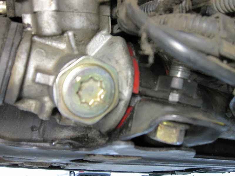

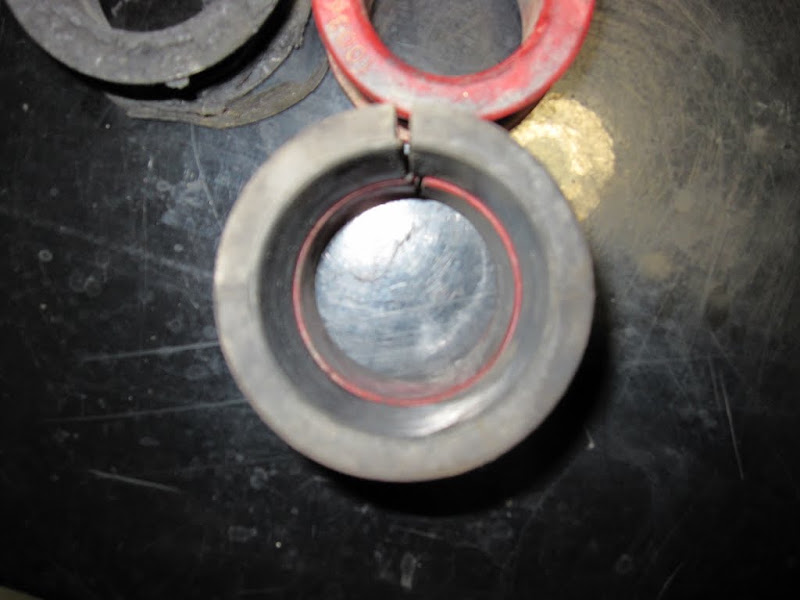

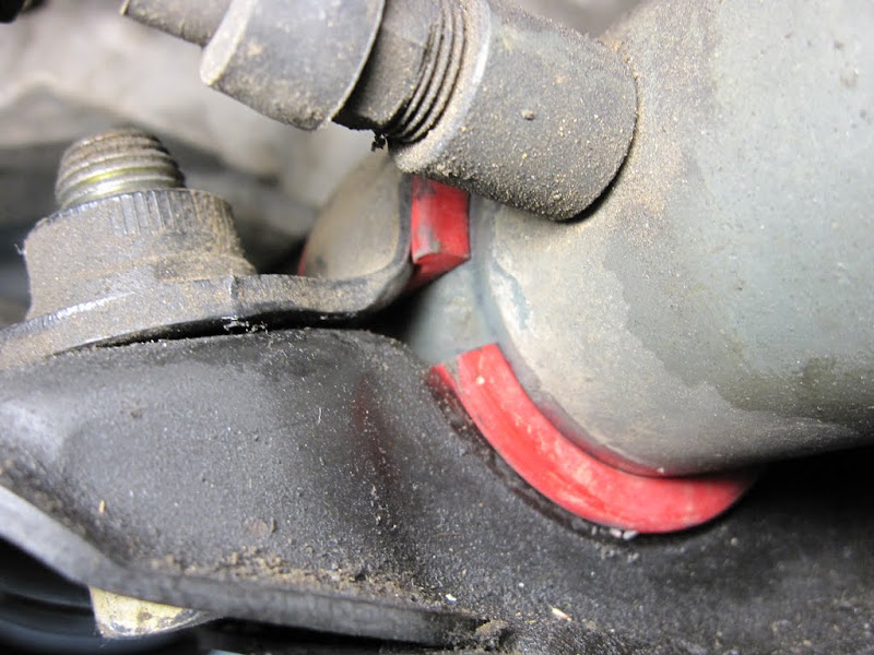

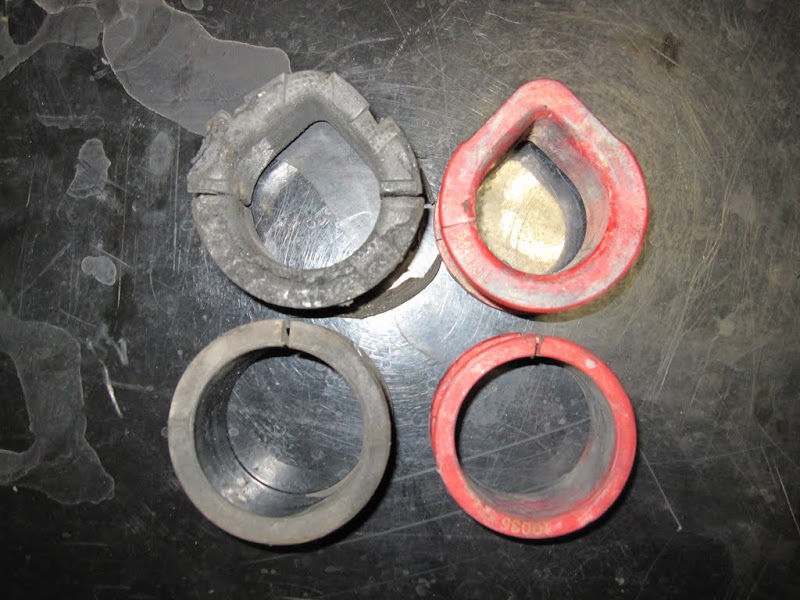

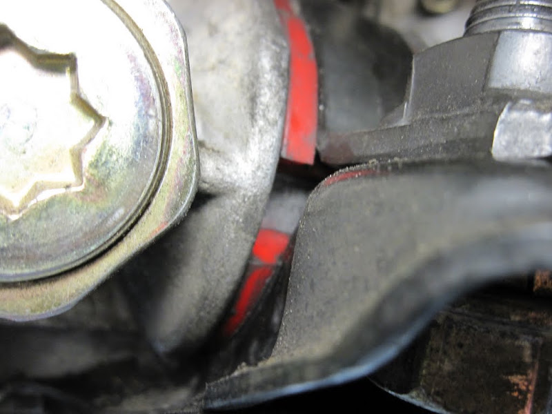

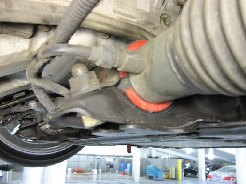

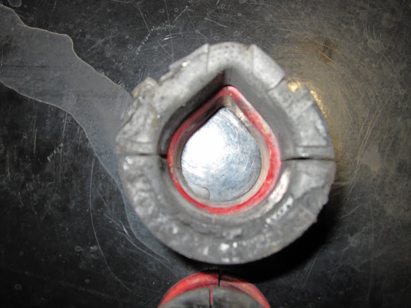

Here's what i got. Excuse the dirt, i dont clean the bottom of my car often and sorry in advance for the crappy pics, they didnt look blurry on the lil 2 inch screen the camera has LOL
This is a comparison of the Y33 and S13 Poly bushings
Comparison of Driver's side
And Passenger's side
Driver's Installed
Passenger's Installed
Basically. they ARE NOT the same size
If ya check out the 2nd and 3rd pics, you can tell the S13's are smaller, especially the driver's side ones
After workin em in, there's a gap in em, and they dont completely close up
being i needed new bushings also, I went ahead and left em in, the gap doesn't bother me, and i tried positioning it so the opening on the bushings, matches the opening on the brackets. The last pic shows this really clearly
[IMG]http://lh3.ggpht.com/_yTr40MAMZU8/S71MR_X6LpI/AAAAAAAAAko/0HthPy18ARw/s800/IMG_0646.JPG[/IMG]
[IMG]http://lh5.ggpht.com/_yTr40MAMZU8/S71MTCzzklI/AAAAAAAAAkw/z5lyQ4o8BnM/s800/IMG_0649.JPG[/IMG]
[IMG]http://lh4.ggpht.com/_yTr40MAMZU8/S71MSSG9T-I/AAAAAAAAAks/ImNoWDb8jz8/s800/IMG_0647.JPG[/IMG]
Driver's Installed
[IMG]http://lh3.ggpht.com/_yTr40MAMZU8/S71MVTvUlKI/AAAAAAAAAlA/n7tiLGujaac/s800/IMG_0659.JPG[/IMG]
[IMG]http://lh4.ggpht.com/_yTr40MAMZU8/S71MUgI8HSI/AAAAAAAAAk8/VROBTE_k7xM/s800/IMG_0656.JPG[/IMG]
[IMG]http://lh6.ggpht.com/_yTr40MAMZU8/S71MTley5NI/AAAAAAAAAk0/u25YVGH_ntM/s800/IMG_0653.JPG[/IMG]
[IMG]http://lh6.ggpht.com/_yTr40MAMZU8/S71MUDy8koI/AAAAAAAAAk4/IlWPEy-3pxg/s800/IMG_0654.JPG[/IMG]
